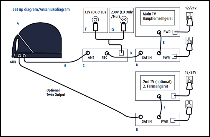

Am o problema cu a gasi programele la o antena automata Maxview VuQube 2.
Am facut contractul cu Focusat, am luat cardul CI+, l-am instalat si am dat cautare in toate felurile posibile, atat cu card inauntru cat si fara. Antena are si reciver si am incercat si cu el, antena se aude cum se invarte cand ii dau sa caute sat, programele, si am incercat si fara reciver, cu cablul direct in tv care are dvbs si s2.
Banuiesc ca e vorba de o setare ceva dar nu ma pricep. Se pricepe cineva sa ma ajute?

Salut @Razvan Petcu
... ai verificat conexiunil (legaturile) ?
Ai  "Manual de utilizare"?
Practic printr-o simpla apasare de tasta, este suficient, pentru ca Maxview VUQUBE Auto 2 sa se aliniaze cu satelitul dorit, in cel mai scurt timp (60 - 90 de sec).
Asa cum ai spus mai sus, sigur "ai sarit un pas" (o simpla setare!). Verifica, pas cu pas instalarea! Succes!
"Powering
1. Make sure all connections are (atentie la cablul coaxial! Nu-l rauci!)
2. Turn on the TV and satellite receiver.
3. Press POWER on the VuQube 2 control panel.If the unit is properly connected, the COAX light should flash for 10 seconds before turning solid. This indicates the VuQube 2 is ready to search for satellites.
If the ERROR light appears, there is a problem with your connection, please see troubleshooting. You will also notice, 1 of 4 SAT SCAN lights will flash 3 times.
This indicates which satellite the system is currently set to.The VuQube 2 supports the following Satellites: Astra 1 - Astra 2 - Astra 3 - HotbirdPlease see table below to understand how the lights correspond to these satellites.""
""The VuQube 2 is preset to Astra 2, this means your system is ready to search for your favourite UK channels. (The Mainland European VuQube 2 is preset to Astra 1, this means European users can also immediately search for their favourite channels.)
In most cases your pre-set satellite will be the one you wish to search for, in this case, please skip to the SCAN section now (turn over).
If you would like to change the satellite which your VuQube 2 searches for please use the following process:
1. Hold down POWER and SCAN simultaneously for 3 seconds or until a SAT SCAN & COAX light begins to flash.
2. You have now entered satellite selection mode. You can now scroll between the 4 satellites by pressing the SCAN button. You will see the SAT SCAN light will move, corresponding to the new satellite you have selected (see table).
3. Once you have selected your satellite, again, simultaneously hold down POWER and SCAN for 3 seconds. The lights will stop flashing. 4. You have now exited satellite selection mode and your new satellite is ready to be searched. Please reference page 10 to view alarm setting options which will follow this step.Note: This will now remain the pre-set satellite on the control box until this process is repeated."""
""Scan
Once your system is set up to search for the correct satellite, you are ready to scan.
To do this, simply hold down the SCAN button for 3 seconds.
The antenna will now begin to search and the SAT SCAN lights on the control box will begin cycling to confirm this. This process can take up to 10 minutes, however in most cases will be considerably less. (de cele mai multe ori dureaza foarte putin!)
Once the VuQube 2 has located a satellite, the SAT SCAN lights will stop cycling and the light representing the satellite programmed to search will turn solid. This confirms that the desired satellite has been located.
Ensuring your receiver is set to the correct satellite, you will now have a picture.
If after 10 minutes the lights stop cycling and the ERROR light appears. There has been a problem locating the satellite; there are several reasons for this such as an obstruction or unstable surface. In this case you should re-setup your system and rescan. Please refer to the troubleshooting guide for more information.
Note: If you move the antenna unit, you will have to re-acquire the satellites by repeating the scan proces"""

Din cate inteleg din manualul de instructiuni, aceasta antena nu stie sa se orienteze automat decat pe 4 sateliti, iar Thor (0.8 W - Focus Sat) nu face parte din lista. Caz incheiat.
